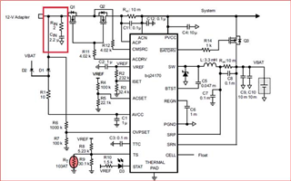

Hi team
Could you tell the purpose of RIN as the attached? Is this required?

Dear Noriyuki,
The Rin and Cin are for the input hot plug filter. Please see Section 10.2.2.4 Input Filter Design for more specifics.
