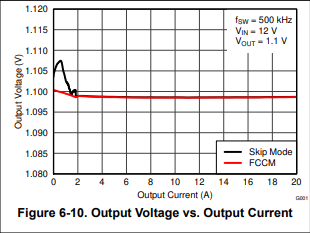

While VVFB is essentially the internal reference voltage, Vref, it also includes any offset from the feedback comparator, so it more accurately reflects the regulation voltage than Vref.
Note: The TPS53353 uses D-CAP mode control, which regulates the valley voltage of the output ripple, not the average, and the reference voltage is increased slightly when zero-current is detected cross the low-side FET during the low-side FET on-time (Load currents below critical conduction). If the MODE pin selects auto-skip operation, the output ripple voltage will also increase as it enters DCM operation. This increase in Vfb(avg) and thus VOUT at light load is noted in figure 6-10
