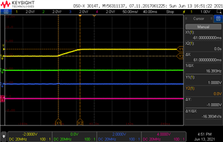

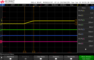

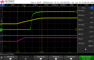

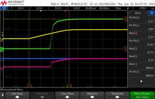

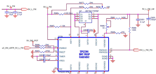

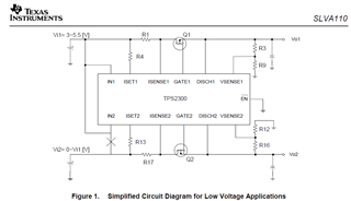

I'm using TPS2301 Controller as a Current Limiter for 5V@1Amax power supply. See the attached picture.
And I have some issue with it. During power up of the system, the controller is falling to Fault state and "close" the Gate voltage.
It means that I see stable Input voltage [5V_L_FIX], but I get 0V on other side of the MOSFET [5V_L_FIX_LM].
No any load on the output stage [5V_L_FIX_LM].
Actual configuration of some components in the scheme for the testing is:
  • R996 - Not assembled
  • R994 - Assembled 100K resistor
  • R997  - Not assembled
  • R977 - Assembled 0R resistor
  • R978 - Assembled 0R resistor
Please advise. Am I made some mistake in scheme design?

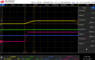

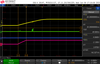

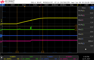

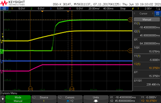

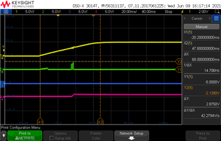

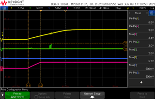

Also, attached start-up waveforms:
1st and 2nd pictures: Yellow - Vin, Green - Gate, Blue - Timer, Pink - Vout
3rd and 4th pictures: Yellow - Vin, Green - Gate, Blue - Timer, Pink - Enable
