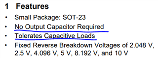

Before TL431 have requirement for the Cload. I am not sure whether our 4050 have the same requirement. Below schematic, Rs=49.9k and C94/Cload=0.001uF, is this ok?

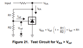

The above schematic looks fine. TL431 has a stability condition only when we are using the device in feedback network as shown in the image below. As LM4050 does not have such network, it is stable reference under the above mentioned conditions.
Hope this helps!
