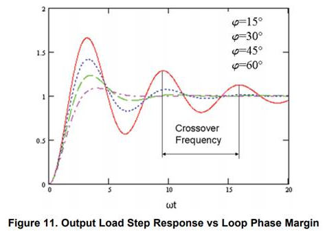

The excel spreadsheet does not have any equation to analyze the loop bandwidth and phase margin. The webench does provide the loop response info but I am looking for math equations to do simple analysis on my own.
On the other way, you can use load transient to estimate phase margin in real circuit. https://www.ti.com/lit/an/slva289b/slva289b.pdf
