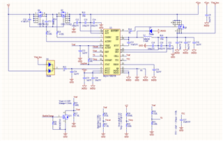

I made a PCB with the BQ24170, but I have an issue :
Charge start, but after a few second charge are stopped (approx 4sec), few seconds later (approx 1/1.5s) charge start again, and so, and so....
Schematic:
Vin = 15V
Lipo are 3cells - actually 11.7Volts
Viset = 508mV
Vovp = 1.23V
TS = 2V (fixed, I haven't NTC here)
Vacset = 660mV
Do you know where can be the issue ?

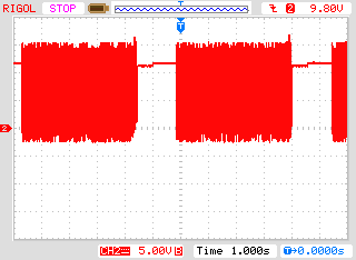

  • When Charging :
    SW signal :
    STAT was tied to GND
    When not charging :
    SW signal is DC, voltage of the pack.

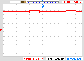

    Please describe, preferably with a waveform of the charge current, what is meant by intermittent charging? I do not understand your problem and need to see some waveforms to help diagnose. Please supply PVCC voltage, SW voltage, SRN voltage, and charge current.
    Mike Emanuel
    intermittent charging : BQxx is charging well during a few seconds, stop charging few seconds (as if it's Off), charge again etc etc.
    Current is mesured with an ampmeter during this test it was 720mA when charging and 0 amp when not charging.
    I take the two pictures when charging at 720mA, when I want to mesure the SRN voltage I see on the ampmeter was charging (without intermittent) at 880mA... I haven't change anaything...
    PVCC on the left / SW on the righ
    4 seconds charging / 2 seconds "OFF" etc etc.

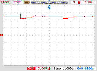

    Voltage between SRN and PGND :
  • My bad !!  The issue is due to the BMS , not the charger !
    I made several measurement and think it was the charger but.... not...
