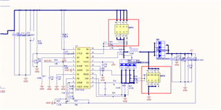

Can LM5118 add a MOS driver for 350W power?Below is the input condition:
Vin=12V-42V ,Vout=48V8A
Hello switch,
For 350W, you need 4 switches instead of 2 switches and 2 diodes. So in general I think even LM5175 or LM5176 gets to its limits at this power. Nevertheless, a 300W reference design is done on the EVM layout, see here: https://www.ti.com/tool/PMP10214
In general, I think LM5176 would be the right device for this appliction. Possibly this will work without external driver.
LM5118 has the limitation that it does not have pure boost mode and as in buck-boost mode both switches switch at the same time, if you just add 2 complementary drivers, 2 switches would be on at the same time when in buck-boost mode. I expect that this would work, but it is possibly not the best solution for such a high power.
Brigitte

The LM5118 buck-boost regulator operates as a conventional buck regulator with emulated current mode control while VIN is greater than VOUT and the buck mode duty cycle is more than 75%.Is there a problem with working like this for a long time ?
Hi Switch,
after a first review i could not see any obvious issue in your circuit. So we need to further investigate.
May you can share more details on when and how the problem occurs:
- you mention that it happens above 48V: is it only close to 48V or the whole range up to the max Vin
- have you tried it with different load currents
- what exactly means the MOS break down. Is it permanently damaged or does it recover?
- What happens with VOut in this condition?
- Can you make a few Oscilloscope shots of: VOUT / SW1 / SW2 / HO signals
