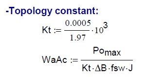

Topology constant formula is given  as below,
But topology constant in some sources is given  as below
topology constant for push-pull : 0,001
topology constant for forward: 0,0005
so where does it come from  (1 / 1.97) * 10^3 ?
And Shouldn't it be 0.001 instead of 0.0005?
