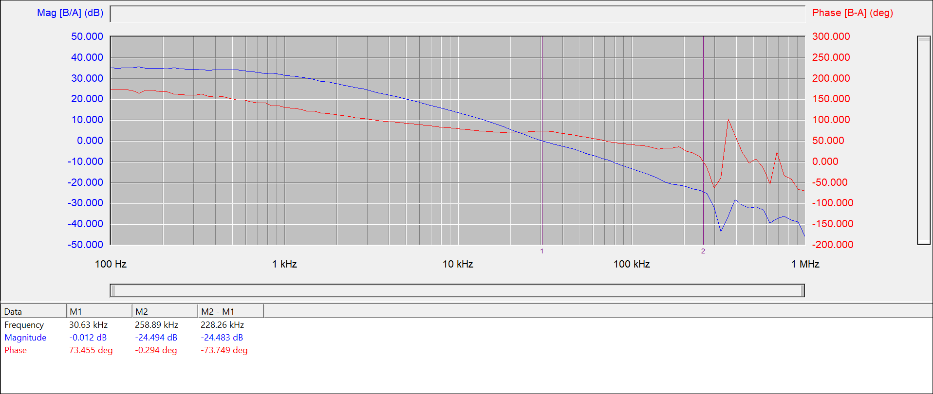

  • Hi T.Morimura,
    I just completed the bench test on EVM with similar components as your schematic:
    L=4.7uH, Rdc=13mohm.
    Cout=247uF, 2*100uF+47uF. I didn't find 3325 MLCC in our lab, so to avoid the degrading of cap, I could only use 100uF Poscap instead. Its ESR is 18mohm, that could bring a zero in loop, the frequency is 1/(2*pi*ESR*C)=88kHz. That could bring higher phase margin compared to the MLCC solution.
    Filter at CSP~CSN is same as yours, 10ohm/10ohm+4.7nF.
    Comp components are also adjusted to the same value as your schematic: 3.4kohm parallel with 1nF.
    Here's bode plot with 0A.
    Here's bode plot with 5A.
    I think the phase margin should be improved to ensure stability.

  • Hi Morimura,
    Andrew will test it today. Will feedback to you soon.
    Thanks for your understanding.
  • Hi T.Morimura,
    I removed the cap connected with comp pin and test again. I didn't change output cap since 235uF (5*47) and 247uF (2*100+47) are so close.
    The phase margin is 73 degree. I think there's no concern for stability with the provided BOM.
    Andrew
