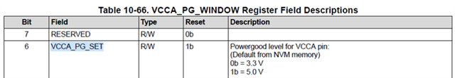

Hello Expert,
Our customer is considering tps65941212 and tps65941213 for use with TDA4VM.
So I have some questions like below.
You can send it to me by e-mail. (michael.jeong@arrow.com)
1. What's the difference between tps65941212 and tps65941213?
    As I know, there is NVM.
    I'd like to know exact difference to support our customer.
2. What's the default setting in VNM for VCCA_PG_SET?
3. When I look at the register of the data sheet, it says “Default from NVM memory”, so it will be different from the reset default value.
    Could you please deliver the NVM setting value?
4. The source power from Common Processor B’D to PMIC is all applied to VSYS_3V3.
    When I look at the data sheet, I think that it is possible to supply power for PVIN_B = 5V, PVIN_LDO/VCCA/VIO_IN = 3.3V.
    Can we use as I mentioned?

  • Hi, Michael,
      TPS65941213 is an updated version of TPS65941212; we recommend using TPS65941213 as primary PMIC and  TPS65941111 as secondary PMIC for use with TDA4VM. Please find attached for the NVM setting value.
      Both PMICs use 3.3V for their VSYS. Leo_PG2_PDN_0C_TPS65941213 & TPS65941111_NVM_Settings.XLSX
    TI_DEVICE_ID=0x82
    TI_NVM_ID=0x13

  • Hi Phil,
    Thanks for your fast response.
    I need to get your opinion about my question No.4.
    When I checked VCCA_PG_SET, it is set 0x0 (3.3V).
    If our customer want to use 5.0V, can't you change NVM setting?
    If you can't change NVM setting, do we have to choose to not use OVP function pin (VSYS_SENSE, OVPGDRV)?
    BR
    Michael
  • Hi Michael,
      The NVM of TPS65941213 as primary PMIC and  TPS65941111 as secondary PMIC for using with TDA4VM has been released and fixed according to the reference deign by TDA4VM team. Customer can't use 5V for VCCA; to use the solution, customer needs to follow the reference design.
      The OVP function has also been decided by the NVM; customer can't change it.
    Thanks!
    Phil
