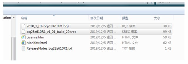

    We have used EV2400 to connect to the chip but we did not recognize Gauge IC.
    The bq28z610 Firmware v0.17 (Rev. B) is seen at ti.com and the bqz and rec are seen after the download
    Would like to consult with you which file to burn in? If not, what is the behavior of Gauge? Thank for your help.

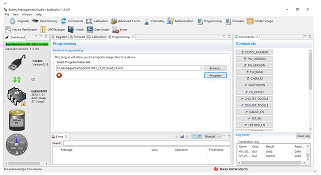

  • Hi Eric,
    Thanks. We can read the IC when change another board.
    May we know how to update the srec file? We cannot update the srec file at firmware and programing interface.  Thank for your help in advance.
  • Feng bin Su,
    The device is not communicating when you are trying to program. My guess would be you are going into shutdown mode. Please apply a voltage > 3V to the pack+ pin to keep the device awake when trying to do the upgrade.

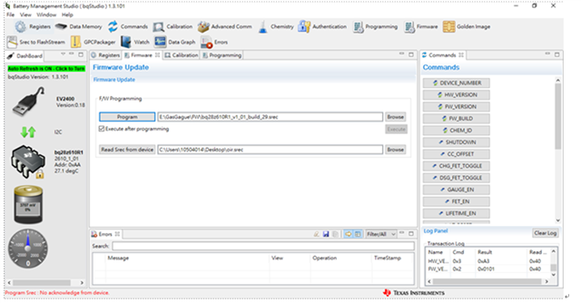

  • Hi Eric,
    My customer has connected from 3.7V to Pack+, and they can read temperature, FW board, SDV bit is Active
    It seems that it haven't left shutdown mode. Hence, we still cannot update the FW. Is there any issue at hardware side or missing anything?
    Due to customer is not very familiar with GAS gaue, there is some question would like to consult with you as below.
    • Why it will show lock picture as the below figure? Does it mean shutdown mode and how do we disable it?
    • Do we need to run calibration every pcs of DUT?   Should we update the FW or calibration for the IC at  production.
