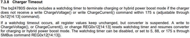

  • Hi Jordan,
    Thanks for the detailed information.
    The BQ24780S has a watchdog timer. When the watchdog timer expires, the converter is suspended, so charging stops. The register settings are preserved, which is consistent with your description. Please try disabling the watchdog timer to see if that resolves the issue.
    Angelo
