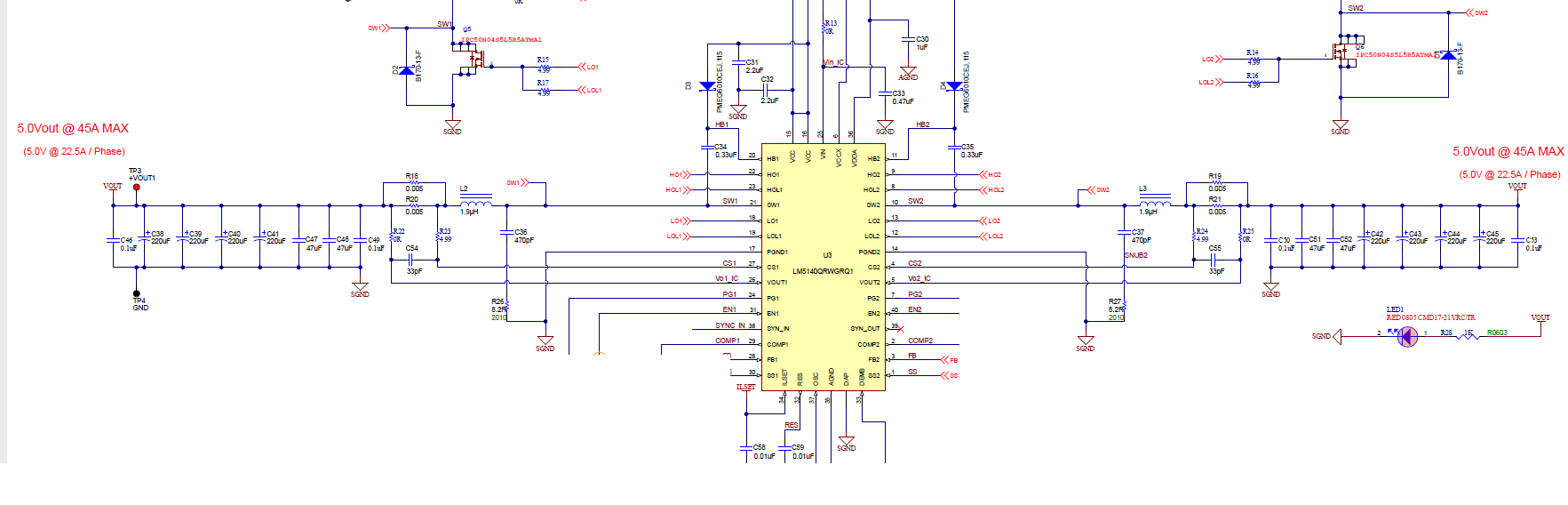

LM5140-Q1: Can I combine the two output together to get a higher current ?
Part Number: LM5140-Q1
Other Parts Discussed in Thread: LM5143-Q1
Hi
1. Can I combine the two output together to get a higher current as below schematics shown ?
2. how to use the calculation tool to calculate the component values for this circuit. Is it correct i set both out the same 5V and 22.5A out ?
