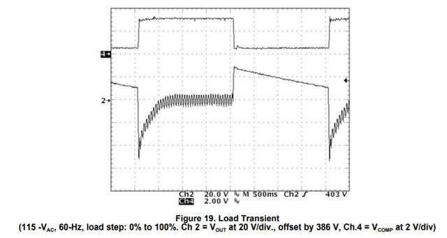

Customer is asking whether we have data regarding to transient test performance from 0A to 2.65A condition? I check the evaluation board file, which only contains from 1.15A to 2.65A one.

Hi, Stanley
The UCC28180EVM is for 360W design which cannot support 2.65A output current, since output power=390V*2.65A>1kW.
There is no load to full load transient performance in the user guide of UCC28180EVM, here it is.
