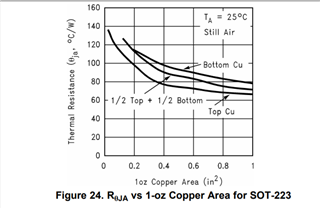

Hello, I plan to use the LM1117-3.3V for my 3V3 Regulated output from a 5V input. The required current output is 0.8A (worst case scenario). I was looking at the thermal resistance curves and wanted to know by how much would the thermal resistance decrease for higher copper areas (say like 3.3inches). The curve provides details only upto 1inches2
Thank you!
