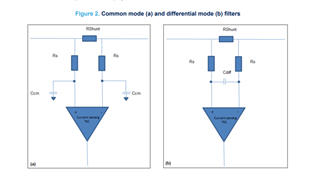

We are charging three 18650 battery packs in series, and the charger is the 12V adapter. The attachment is our schematic diagram, please help to check whether the configuration parameters are OK.
In addition, please help to provide the I2C control case of charging for our reference.2860.BQ25703A.pdf

    1. For ACP-ACN current sense filter, please refer to the EVM for values to use. Also recommend a differential mode filter on the pins.

    7. Add a cap (or a placeholder) between SRP and SRN for differential mode filter.
