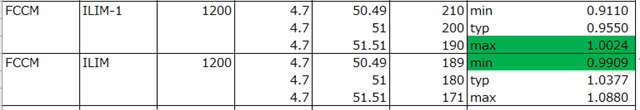

  • Hi Aaron,
    For TPS56C215, firstly we strongly recommend to use 1% resistor for Mode pin resistor. Your calculation is correct, if using 5%, some of the mode voltage will have overlap. That's why we strongly recommend 1% resistor. For DS description, we need to correct it and 5% is not correct. Sorry for the misunderstanding.
    As for your last question, there is the possibility to have overlap as below. Recommend to use 1% mode resistor.
    Lishuang
  • HI Andrew
    Thank you very much for answering
    I know that RM_L=51k(1%), RM_L=180k(5%), RM_L=51k(1%), RM_L=200k(5%) overlap,
    But what I want to know is, mode resistance range(IC decide range )
    E.g
    5 mode 0.9V~0.99V
    6 mode 0.99V~1.09V
  • Hi Aaron,
    For 5 Mode (51K, 200K), 0.9-0.99V is okay.
    For 6 mode (51K, 180K), 1.03-1.09V is okay.
    Lishuang
