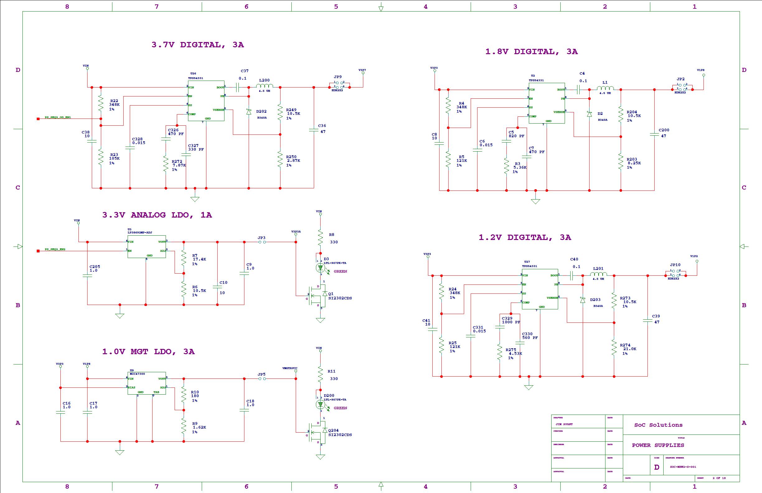

I have designed a board with three TPS54331 parts.  In the past I have successfully designed boards with similar TPS54232 supplies and have done several other boards with other switching supplies. One of the 3 supply circuits is working (3.7V output) but one two are not (1.8V & 1.2V).  I made the mistake of driving these 2 supplies with 3.3V instead of the 3.5V minimum in the datasheet.  I increased the 3.3V supply to 3.55V but these 2 still are not working while the one driven at 5V is working fine.  I also tried replacing both TPS54331 parts and a few of the components around them but the circuits act the same.  The output voltages don’t come up to the proper voltage (0.85V & 1.01V instead of 1.8V & 1.2V respectively).  I even bought new parts from a different vendor and replaced again with no help.  I'm using 4.5uH, 4A rated inductors for all 3 supplies.

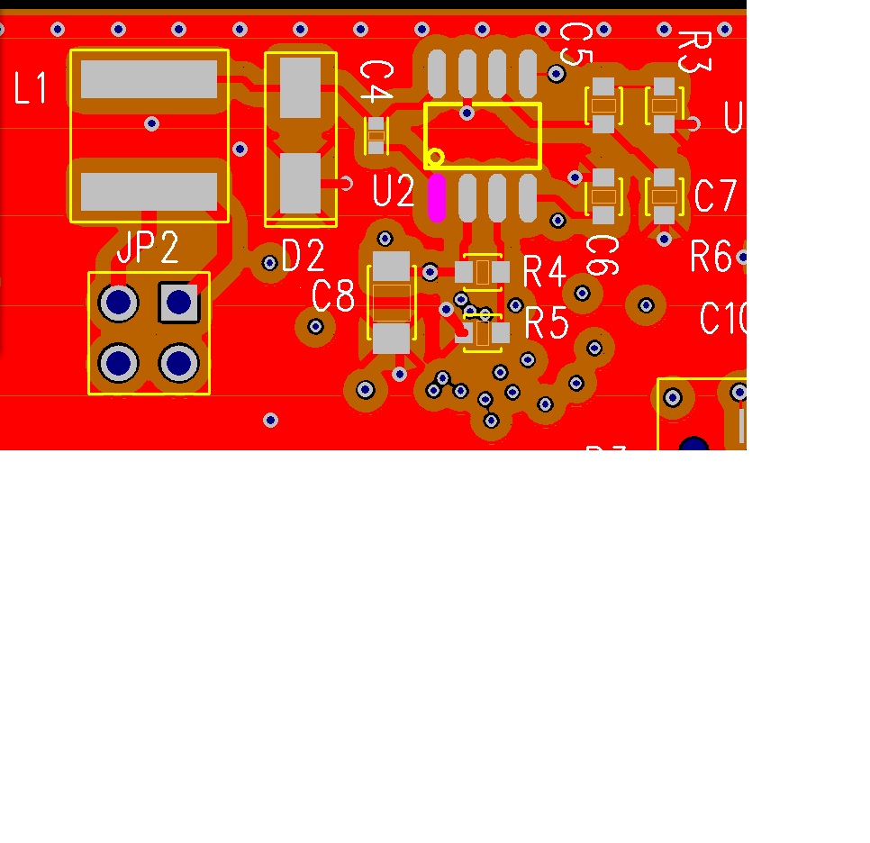

I am testing with the non-working supplies unloaded.  I don’t see any evidence of switching on any of the pins.  I have reviewed the layout and don’t see any issues there.  This is a 16-layer board with LOTS of ground.  The working circuit is placed side-by-side with one of the non-working circuits and the layout is almost identical for both circuits.  Is there a reason this part would not work with light or no load?

  • Can i see schematics and waveforms?  If you are building up these designs on bare boards with only the supply circuits populated, then I have to beleive it is a layout issue.  Did you follow the layout guidlines?  The most critical issue is to have the input bypass capacitor as close to the IC as possible.

  • You should be able to attach files. Use the "paper clip" icon second from right  above
  • Please see attachments. Input cap is C8.
  • Try removing, R4, R5, R24 and R25.  let me know if that works.  Otherwise I will need to see waveforms.
  • That has already been tried.  Nothing I can do with Ven makes any difference.  What I find most odd is that as I crank up the input voltage, one supply seems to regulate for awhile, then as the voltage increases, it goes out of regulation, while the other one starts regulating.  I can't find an input voltage that makes both circuits stable, while the design software indicates they should both be very stable across a wide range of input voltages.
