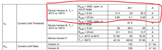

Hi team,
Could you tell me how much current limit ratio min and max is for TPS2HB16A-Q1?
I am interested in current limit ICL min and max value.
I found that ICL = KCL / RILIM shown in equation (1). To decide ICLmin and ICLmax, we need KCLmin and KCLmax in addition to KCLtyp=102 [A*kohrm].
