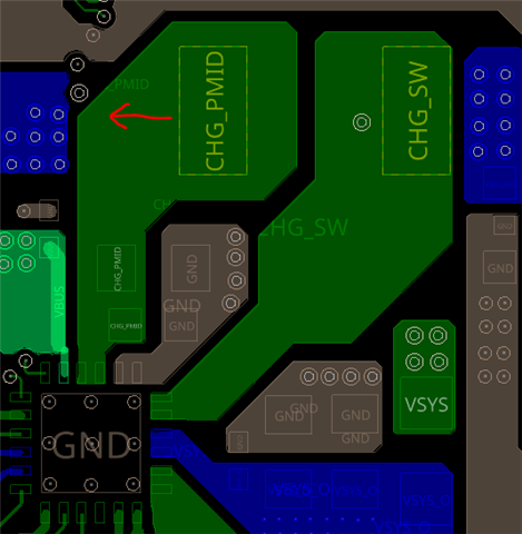

   This is Mickey Lee, EE lead of Electro-Acoustic R&D, Luxshare-ICT (Taipei), our new project adopts the boost-mode battery charger IC BQ25883 and
   related schematic & layout are also attached in here, please help to review and provide your adjustment recommendation

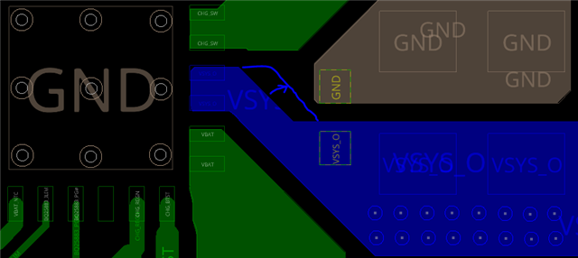

    Here are my comments on the PCB layout:
    1. Please move inductor L801 to the left, slightly closer to the BQ25883.
    2. It looks like there is space to widen the VSYS copper pour.

  • Thank you very much and we'll follow these comments accordingly.
