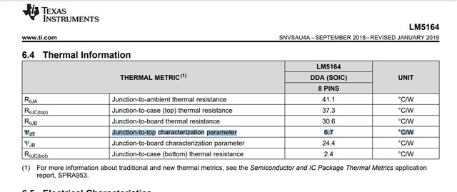

Hi, Sir,
We are evaluating thermal performance and wander if we could take ΨJT as the thermal parameter when there is no heat sink on top of LM5164.
Thank you.
Jeff

Hello Jeff,
Yes; ѰJT should not be used when application of a heat sink is intended.
