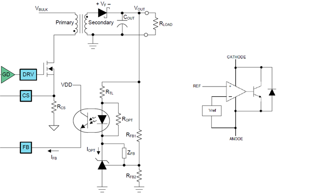

I am assisting customer to design with UCC28740 and have few questions about its control law.
Based on the control law shown in datasheet, the primary peak current and frequency is depenons on the Vcl, which is generated by the current flow into FB pin.
Lower FB current lead to higher Vcl indicate heavier load in output side.
The feedback pin current decrease means the current flow throungh the opto-coupler is decrease either.
I not fully understand how the secondary feedback network to adjust the current flow through the opto-coupler during heavy load condition. Is it a fixed voltage error is needed to generate such current?
  • Hi Gabriel ,
    As load increasing , the output voltage will a little lower than regulation voltage, there is a error amplifier in the 431(shown in below image left side), the internal error amplifier will increase the impedance of 431's CATHODE pin , then in Iopt will decreasing (shown in below image right side ). in this way , the out load will influence the primary side IFB current. Hope this can answer your question. Thanks.
