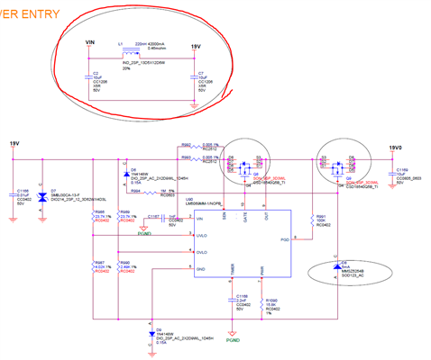

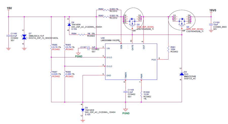

Dear team
There is a good news that we design in LM5069 in customer's new project.
The spec is Vin=19V Io=12.5A.
Could you help to review the schematic and recommend the solution of  Q8 and Q9.
Many thanks
