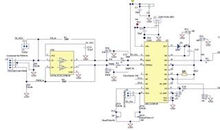

First, since the module is using an Schmit-trigger buffer I don’t expect to experience a difficulty in getting an output, but to our surprise getting the output at pin4 has been a challenge. Thus we think of bypassing it (buffer)  but it gave a similar challenge due to missing R31.

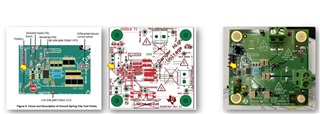

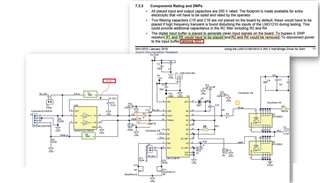

 From SNVU572- January 2018 document, section 7.3.3 bullet no. 3, there is a recommendation for bypassing the buffer IC (U2A). The R31 is clearly not present on the board. Placing the DNP resistors (R1 & R8) and removing the connecting resistors (R2 and R3) doesn’t make sense to me.  I have color coded the wording from the documentation wrt the actual location of components from schematic. An actual board photo has been put side by side with the EVM Assembly drawing and PCB layout snapshot showing the location of the R31 (yellow arrow)

  • Hi Furkan,
    Thanks for reaching out!
    I agree that it does not make sense to remove R2 and R4.

    { Yes, as you know in the PWM configuration Pin 1 of SN74LVC2G17 is tied to +5Vdc thru J3 jumper and this input voltage is coming from the LMG1210.  I can clearly see also a 5Vdc going to EN pin of LMG1210 thus the buffer is fine with steady DC input. PWM signal is also fine from my checking- I tried several clock shape as well but not getting the right output }
    We have ordered additional boards to check if this difficulty will be observed as well getting the output of PWM to the LMG1210. At the moment, for unknown reason the LDO of LMG1210 is no longer working thus it is not powering on the buffer.
    Isolating the buffer from the circuitry (cut the trace from Pin5, and removed R2 and R4) ,  I have supplied the Vcc+5 from external PSU and tried PWM signal to both channels (one at a time) but did not get output from either of the channels. Steady DCin to either of the input pins will give an output.

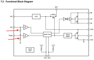

    Regarding the R_IPD spec, that is found Section 6.5 - Electrical Characteristics.
    The resistors the R_IPD spec is referring are these ones:
    They are the internal resistors values within the IC.
