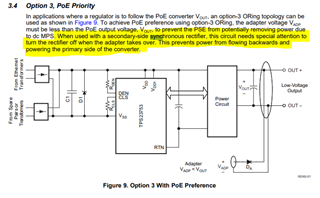

I am working on a new design and intend to use TPS23730 as my PoE PD chip. External power adapter is also used to provide power to the board in case of no Ethernet PoE is plugged in.
Priority is given to the power adapter in case both are available (adapter and Ethernet PoE).
I did go over your Application Report SLVA306A "Advanced Adapter ORing Solutions using the TPS23753" document, in particular for Section "3.5 Option 3, Adapter Priority" on page 13 I did not understand the part that talks about synchronous rectifiers problem, highlighted in the attachment below,
Can you please talk a little bit more about the problem and how to disable the rectifier?.

    The problem is described in section 3.4:
    A MOSFET can allow power to flow in the opposite direction, so you need to prevent this from happening with a diode or a output blocking MOSFET.
    Alternatively, you can use a Power multiplexor and program the priority you want. That would be my suggestion for a synchronous output.

    I did refer to section 3.4 in my question, but it is still not clear to me the turn off needs to happen.
    Could you please explain a little bit more in details with diagrams if possible, thank you.
  • You do not want your adapter backdriving your design -- sending power from the secondary side of the transformer to the primary side. That could cause damage and unpredictable behavior.
    Because MOSFETs can be turned on and allow current to flow the other way, you need to be careful to ensure this does not happen. This does not happen with diodes since diodes always block reverse current and cannot be accidentally turned on in this architecture.
