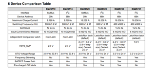

We are using the BQ25703A in a current design, but stock issues mean we are considering other options.
1 - How likely is the BQ25700A to interoperate on an I2C bus?
2 - I see some distributors advertising a BQ25703RSNR or BQ25703RSNT. Is this a related but obsolete product? If that's the case, we might be able to use that to get through the current part shortage. However, I haven't been able to find a datasheet anywhere. Did this part ever exist? If so, can anyone point me to a datasheet? Or are distributors who claim to be selling it, actually just mislabelling the BQ25703A?
3 - Are there other parts in that family, that are similar enough in performance, that we might consider them as alternatives?
