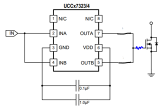

Hi expert,
As this device is a dual channel driver, would like to learn below:
1. Are these two channels fully independent to operate? No any logic limitation for PWM input and output, right?
2. If two channels are used in parallel, wonder if below is allowed or not.
In my opinion, if two channels match well, it is okay; But what would happen if dis-matching is serious? Will OUTA and OUTB have circulating current(faster high output will send current to slow one)?

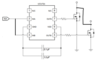

3. If I have two MOSFET in parallel ideally(ignore paralleling parasitic between two MOSFET),
Do you recommend to connect OUTA and OUTB separately to each gate of MOSFET, or tie OUTA and OUTB together, tie gate A and gate B together, and then connect them?
In my opinion,  no.2 will be better because MOSFET switching always behave at the same time, no matter if dis-matching is serious or not. Correct?
4. Based on no.3, if two MOSFET are not in ideal parallel, what's the conclusion then?
I prefer no.1 connection then, would like to learn from your analysis.
    For the driver concerns, the circuit you show in diagram one is OK if that is the preferred connection at the system level. If you are driving two MOSFETs the connection you show in second diagram, each driver driving separate FET with have the advantage of there not being a direct mosfet gate connection which may be a concern.
    If connecting the driver in either case, the internal channel to channel delay matching of each device is very good. It will help to drive the driver inputs with fast slew rates to minimize any very small difference in delays.
    This driver has been used driving the two channels in parallel in previous applications.
