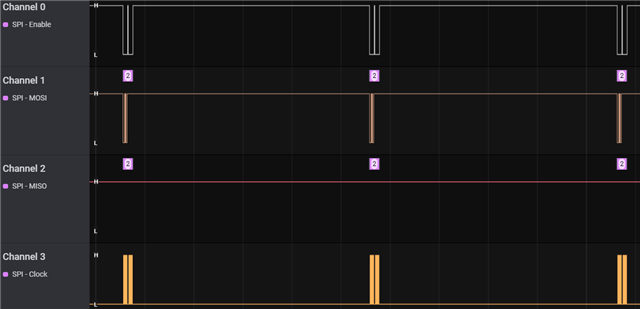

I am trying to communicate with the BQ76952 from the EVM board over SPI but have not been successful yet.
With the bq studio I activated all the necessary registers like it is descripted: REG12 = 0x0d, REG0 = 1, Comm Type = 0x0f, SPI Config = 0x60 (changing entries without writing to the device and then loading the configuration of the device again, confirms that the BQ has the correct configuration ...)
Then I disconnect the jumpers on J19 and J16 to disconnect from the onboard MCU.
And on J15 I put a jumper to activate the pull-up to the 3.3V on the MISO line.
My programm from an external MCU writes two bytes on the MOSI line 0xE6 and 0x82, which I also crosscheck with an oscillsocope. (correct CS-line goes activ-low, correct CLK with 1MHz, and correct data)
But unfortunetly the BQ does not do anything. The MISO line stays high and it does not even return 0xff.
Do you have any idea what could be the issue? Did I forgot someting to configure or to activate?
Thanks for your support!

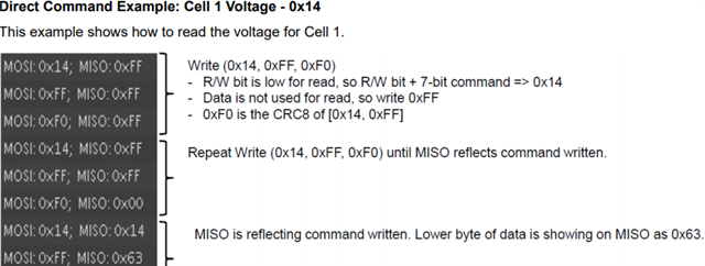

  • Hi Martin,
    I suggest first using the EVM to communicate in SPI mode to make sure that SPI communication is successful. With SPI Config = 0x60, you should not need a pullup resistor on the MISO line. It will drive 0V and 3.3V according to your REG12 settings.
    The steps to set up SPI on the EVM:
    • Set the registers in Data Memory (REG12 = 0x0d, REG0 = 1, Comm Type = 0x0f, SPI Config = 0x60). Measure the REG1 pin on your board to verify it is set.
    • Send the SWAP_COMM_MODE() command. This can be sent by click the SWAP_COMM_MODE button on the command window.
    • Now the device should be in SPI mode and should not communicate with BQStudio. Click the 'Refresh' button on the Registers screen to verify.
    • Set the J13 and J16 jumpers to the SPI position. Populate the J10 and J19 jumpers (make sure J19 is set to SPI position).
    • Restart BQStudio. It should now be communicating with the device in SPI mode.
    Once the EVM is working in SPI mode, you can write the settings to OTP if you want. This will change the default mode for the device. The instructions for writing to the OTP are listed in the EVM User Guide. This would also be a good time to connect a logic analyzer to see how the SPI format looks between then on-board MCU and the device.
    Now you can remove the J13,J16,J10, and J19 jumpers and connect your MCU. I suggest taking a close look at the examples in the BQ76952 Software Development Guide. I am also attaching a working SPI example below for your reference using an ARM based MCU.

    One thing I should also note is the BQ7695204 part number comes pre-configured with these exact settings, but you may already be aware of this.
    Matt
  • Hi Matt,
    first of all, thank you for your quick reply and detailed help, which helps me a bit so far.
    But unfortunately I did not get the SPI comm working with my external MCU. SPI works with the onboard MCU and bq-studio.
    I took the SPI routines out of the code file you had attached.
    But the MISO line stays high all the time no matter what kind of command I send on MOSI.
    This is what I get all the time.
    According to the description in the sw development guide, the device should at least send something over MISO.
    I can exclude a hardware issue on the side of the external MCU because even if I do not have the MISO connected but only measuring with the oscilloscope, nothing happens on MISO.
    Maybe you have an other idea what could be wrong here?
    Martin
  • Hi Martin,
    The first couple readings should be 0xFFFF as shown in the example of reading from Cell1 in the SW Development Guide. But the third time should send the cell voltage data. Maybe you can capture the timing of a Cell1 voltage read using BQStudio (turn off the Dashboard and read from 0x14 in the Command Sequence window) to see if there is any major difference in the timing vs. your microcontroller.
    When you connect your MCU, I assume the EVM is still powered and no reset command has been sent (which would reset the device registers to default values)?
    Matt
