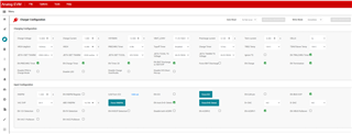

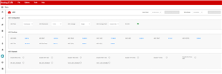

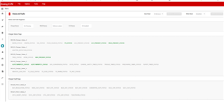

    Can you send the status and fault register screen as well as the current ADC screen?
    Jeff
  • Hi Carey,
    I don't see any thing wrong with the settings.  Is the /CE pin on the EVM shorted to ground with the shunt on JP17?
    Jeff
  • Yes, JP17 is installed. I rechecked all the shunts and they match the Users Guide.
  • Is there a specific connection sequence I need to use to connect the battery, Vin and Load?
  • HI Carey,
    The IC was designed expecting that the battery is installed first and is never hot plugged (i.e. battery installed while power is applied).  Even if power is applied first, the IC may reply faults but should recover once the battery is installed.
    Can you send the chip configuration page from the GUI as shown below?

  • Hi Jeff,
    I've had to take my test set apart for a couple of days (end of month & quarter shipments) but as soon as I put it back together I'll send a screen shot of the configuration screen (and the other screens since it will be a new power-up for the board).
