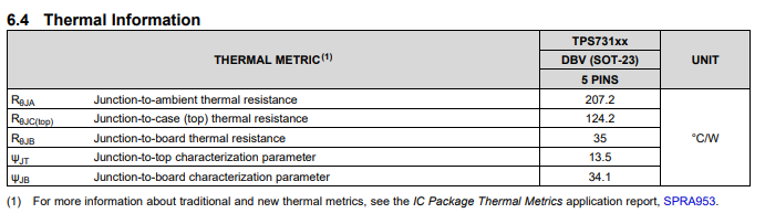

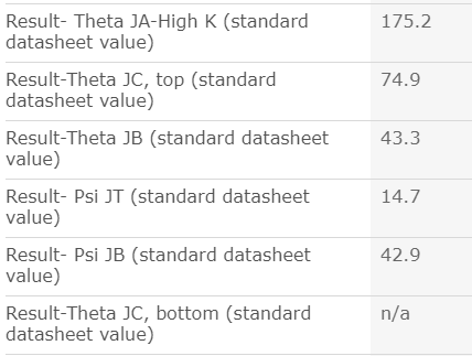

I am wondering if the junction-to-case and junction-to-board thermal resistance values are available for TPS73101MDBVREP?

Hello Sadab,
I made a mistake. I will need to submit a thermal modelling request to find the values of RθJC and RθJB not present in the TPS73101-EP datasheet.
Those values will be available in 5-9 business days.

Hello Sadab,
I actually reached out to the thermal team yesterday for an update on this and will get back to you as soon as they reply.
Here is the link to the request, let me know if you are able to sign up for alerts.
Juliette
