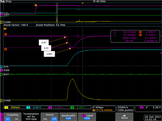

Scenario 1 : Vin = 4.3V
Scenario 2 : Vin = 4.4V
Question is, why is the SYS voltage not building up to full 5 V in one case, whereas it is building up to 5V in the other case?
With the voltage supervisor connected, this phenomenon of retry is worse. Hence we are looking to understand why this is happening in the first place.
  • Block diagram of the above experiment
  • Additional information.
    Minimum VAC voltage (dip) in scenario 1 = 2.84V
    Minimum VAC voltage (dip) in scenario 2 = 2.88V

    Both the scenarios do not have voltage supervisor + load switch. It is removed from the circuit.
    In both the above 2 scenarios, Vin is given directly at the AC pin of PMIC.
    The two waveforms are for PMIC input directly connected to external supply, but with different input voltages (4.4V and 4.3V)
  • As per the datasheet section 8.3.9.1,
    " the device powers up if the AC or USB input voltage increases above 4.3 V. After powering up, the input voltage can decrease to a value of VUVLO + VOFFSET (for example, 3.3 V + 200 mV) before the device powers down."
    Here in the attached figures, even when Vin goes < 3.5V, VSYS is building up. Is this expected phenomenon?
    Is this most recent waveform indicative of a scenario where VIN = 4.4V and so the system powers up, but as you decrease VIN, the device does not power down even at 3.5V? Is there a UVLO voltage that the device does appear to have to reach before powering down?
    Emily
  • Hello, the most recent waveform above is indicative of the scenario as described below:
    Input voltage given to PMIC is 4.4V. The inrush current demanded by the output capacitance connected to SYS pin (output of PMIC) causes the input voltage to at PMIC AC pin to dip to 2.88V for a transient duration.
    As mentioned in the datasheet, the voltage removal detection is 3.5V
    I can see that the PMIC is trying to turn off the linear power path switch from AC to SYS, as soon as the AC voltage drops to 3.5V.
    Question 1: Even when AC voltage drops lesser than 3.5V, why has the PMIC not turned off? Is there a deglitch time where it does not consider the voltage dip?
    Question 2: If there is a deglitch time, then why was it not applicable in the 4.3V (Scenario 1 image in the top). Here the PMIC has turned off.
    There is a UVLO deglitch time of 4-6ms, so it's possible that if the AC voltage drops <3.5V less than the deglitch, it will not recognize this brownout.
    I am curious about the 4.3V Scenario you attached scope shots of though- why is there a voltage on VBAT that ramps up initially with the VSYS at all? If the only difference between the 4.3 and 4.4Vin scenario is input voltage, there shouldn't be any VBAT voltage if your system does not have a battery attach. It appears to me that there is not sufficient output capacitance close to the PMIC- VSYS startup appears to be choppy ramping up to 5V, which could indicate that the output voltage is exceeding the reference voltage.
