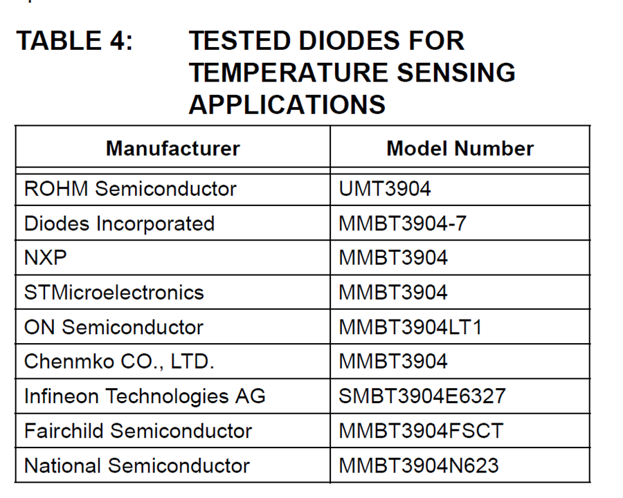

Are you having issues to source a 2N3904 NPN for this application? I pasted below a list of similar part numbers (from a Microchip app note found online), which would also be applicable.
This device assumes n=1.008. We will see a gain error in the temperature proportional to the difference. As long as we keep the n close to this value, the reported temperature can be within a few degrees of the measured value.
Approximately:
T_reported = (n_actual / 1.008)*T_actual
