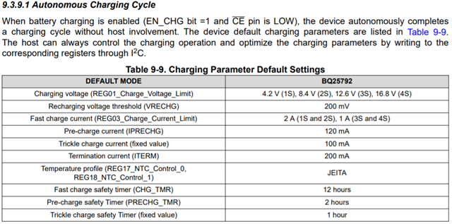

  • Can BQ25792 operate without host processor intervention similar to SMB1.1 with smart battery? - Patrick
  • Hi Patrick,
    The BQ25792 can charge the battery using the default charging parameters in Table 9-9 without any host involvement. The host MCU can change these register settings through I2C. However, for full SBS 1.1 compatibility, note that the BQ25792 does not have an AlarmWarning() register either.
