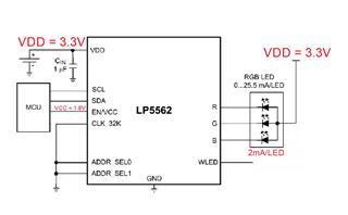

  • For clarity... here is our setup.
    We are using these LEDs:
    www.kingbrightusa.com/.../APHF1608LSEEQBDZGKC.pdf

    Yuki when you power on the system and just enable the CHIP_EN/enable internal CLK/set LED_MAP to zero, will the LEDx be on?
    If the LEDs are off, set address 02 to 0xff then set it to zero. If the blue LED can not off, set 0x00 to register 0D and feedback the result.
    in addition, test the VOUT_R/G/B when blue LED is on or off.
    Best Regard
    Monet Xu
    • when PWM == 0, led is off
    • after Reset, led is off
    • only problem is when PWM=FF and CURRENT=0, BLUE LED is BRIGHT BRIGHT BRIGHT, which does not match 0 uA
  • Hi Monet,
    Here are the measurements using the green LED:
    Green current is set to zero
    PWM is set to 0xff
    VDD is 3.3V
    • Voltage between Green and VDD => 2.25V
    • Voltage between Green and GND => 1.03V
    • Current is 0.4mA
    -Yuri
