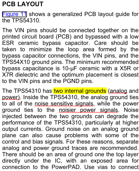

There seems to be two ground: analog ground and ground here. But in the PCB layout I see they are actually all tied together. Why?
And on page 9, PCB Layout, internal analog and power grounds are said to have different functions and are connected to different (noise sensitive signal, noisier power signal). But since in PCB layout the two grounds are physically tied together, how can they differentiate then who is tied to noise sensitive signal and who is tied to noisier power signal?

  • Yes, you will need to tie AGND to PGND at one point.  I recommend right at pin 1.  If the grounds are connected at a single point, no circulating currents can occur.

  • I did not design or lay out the TPS54310 EVM, so I cannot directly comment on the techniques applied by the designer.  However it looks to me like there is only one ground net named GND2.  It is connected to AGND at pin 1.

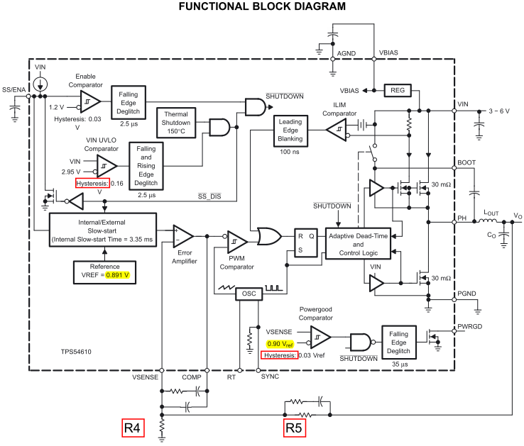

    I take it from your questions that you are not familiar with switching power supply design.  In  switching dc/dc synchronous converter, ther are high current paths in the topology that trasmit power from the dc input to the dc output.  When the high side switch is on, the current flows from vin, thru the high side switch to the output inductor.  The AC current is shunted to ground by the output filter capacitor, while the dc portion is supplied to the load and also returned to ground. when the low side switch is on the conduction path is from ground thru the low side switch to the inductor.  So these are the power ground paths.  They are considered noisy as the switching currents in teh high and low side FET have very fast slew rates.  These fast di/dt's can interact with normal PCB parasitics to generate a fair bit of noise especially at higher current levels.  There is also analog control circuitrs such as the erroamplifierr, RT clock pin slow start circuit etc.  These are low level signals that are sensitive to noise.they are best termonated to an isolated "quiet ground" separate from teh power ground.  This is good design practice, but not always necessary, especially on lower current designs.  Since all the ground signals are "common", they need to ne at the same potential.  Tying them together at a single point does this.  to allow circulating current between analog and power ground, they must be conected together at more than one place to allow for a "return" path.

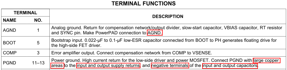

    The power and analog grounds are local the TPS54310  PGND is for the switch returns, AGND is the return for the internal analog circuitry.

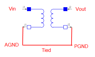

    May I use such analogy for AGND and PGND of TPS54310?

    Your analogy is similar, but what you show is more correctly "primary ground" and "secondary ground" for an isolated converter.  But yes there are two grounds that are meant to be tied together.

    2. Regarding the "high side" "low side", could you sketch them in the following picture? When you say "FET", do you mean those 30mOhm FETs on the right of the image? There are four of them, so are the two on the upper "high side", and the two on the lower (one at PGND, one at PWRGD) low side?
    3. Why there are no FET close to AGND (on top of the diagram)?

  • For switching power supplies there are circulating current paths on the input and output. The GND (PGND) portions of these circulating paths tend to be noisy. Some converters provide for a separate analog (AGND) ground. This is used to terminate sensitive analog circuits. The idea is to keep this separate from the noisy PGND but to keep it at the same GND potential it is connected at a single point. With a single point connection, no current can flow from the PGND to AGND as for current to flow a second connection or return path is required.
