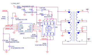

I use LM381 to boost from about +8V (V_CHG_OUT) to +40V and -40V (right side of transformer)
But sometimes my Power MOS might be broken by burn down at Drain
The Power MOS I used is SPR100N03, spec as below. Also my schematic.
Is there any possible reason?
The current through Drain-Source is about 2.6A, and Fosc is about 208kHz
Thanks.

    Thanks for reaching out. What is the design target for your output current? What is your desired peak current set with the sense resistor? Could you please specify the characteristics of your transformer as well? I'm looking forward for your answer.

  • Hi EM,
    The output might be mA level for comparators use.
    The current with the sense resistor is about 50mA by measuring.
    The transformer is as below
    https://pdf1.alldatasheet.com/datasheet-pdf/view/947384/WURTH/749196238.html
    Thanks for your help.

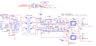

    Thanks for your feedback. When exactly does this damage happen? Is it instantaneous as soon as you turn on your power supply? What is the value of your output caps? Could you please try to capture the waveform at the drain of your FET to see if the RCD clamp is clamping correctly the reflected voltage? If possible, could you please share the schematic of the whole circuit including the output caps and the feedback? I'm looking forward to hearing from you.

  • Hi EM,
    I'm not sure when damage happen. It seems to be the time turning on power supply, but not every time.
    Some devices may happen, and some may not.
    Here is secondary side schematic.(RCD is not installed)
    Vd waveform as below with VOUT= +/-50V (Flyback secondary output Nps = 1:2), VIN= 12V (heavy-loading), overshoot < 45V

    Thanks a lot for sharing this information. I would suggest to populate anyway the RCD clamp to protect the drain of the FET. Can you share the layout of this board? Did you notice if the board was overheating as well?
