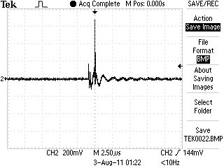

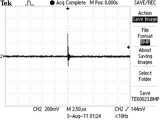

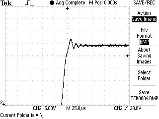

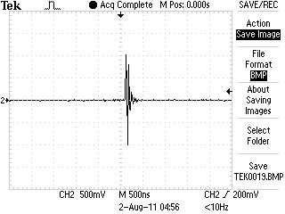

  • Here are some traces of battery connection:
    SRP to GND:
    SRP to SRN:
    SRP to GND with C10 and C2 removed:
    SRP to SRN with C10 and C2 removed:
    As you can see, the voltage spike on SRP peaks at about 28V and then settles to 24V. The voltage spike from SRP to SRN is bad with the SRP cap in place, but there is still a spike with the cap removed. The datasheet says the absolute maximum SRP to SRN voltage is +/- 0.5V. The spikes are exceeding this voltage. Do you think this could be causing the failure?

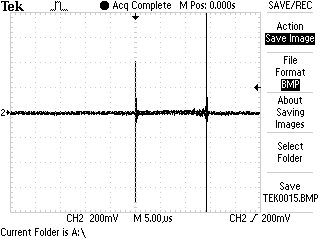

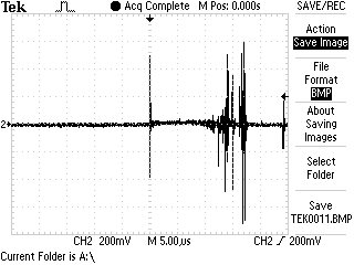

  • I have followed all of the PCB layout guidelines in the datasheet. The 0.1uF cap between SRP and SRN is as close to the IC as possible, and the SRP and SRN traces are parallel (10mil spacing).
    You say the 0.1uF cap is used to clamp voltage spikes between SRP and SRN, so I just increased it to 0.2uF since I still was seeing spikes. However, after I did that and connected the battery I had a part failure. I captured the waveform when it failed:
    So you can see increasing the capacitance between SRP and SRN actually increased the voltage spike to 1V and caused a part failure. So maybe I should reduce the capacitance?

  • I changed the cap from SRP to SRN to 0.01uF and I still had a failure. The failure seems to be unrelated to the cap from SRP to GND or SRP to SRN.

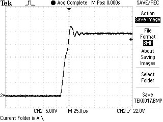

    I decided to go back to the Evaluation Module and measure SRP to SRN on that. Low and behold after a few measurements I had a failure on the Evaluation Module!!!!
    Now I am convinced that I am doing nothing wrong, and that there is either a defect in the part, or the part is just not capable of operating at a 24V battery voltage.
    I think TI needs to do some re-evaluation of this part and revise the datasheet accordingly. Now I am stuck with this part on my board, and I think the only interim solution may be to use an inrush current limiter on the battery line.
    Here are some traces of SRP to SRN on the Evaluation Module. The second one is when the failure occurred:
