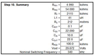

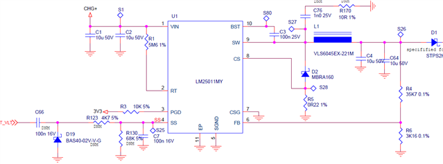

  • Strange.. Can you also provide a circuit schematic? I double-checked the calculations and they are correct. Below is a summary of recommended component values for the application requirements provided. The Quick Start Calculator tool (link) was used. I would like to review the circuit and make sure it is okay.

    The Rt value in our design is 5.6M. Not 2.115M.
    If calculating with Rt = 2.115M, Vin=34V, i can get a Ton = 2.566us.
    But in our application, Rt=5.6M, Vin=34V. Calculation result is 6.768us. While my test result is 2.7us. Even it is not at current limit mode, the tested value is 4.52us. This is a big gap.

    • Please provide a schematic for a review. We would like to make sure all is properly connected.
    • With an RT of 5.6MΩ it results a fsw of 130kHz, which does not correlate to what you provided of Fs equal to 210kHz to 340kHz (that's one point of interest).

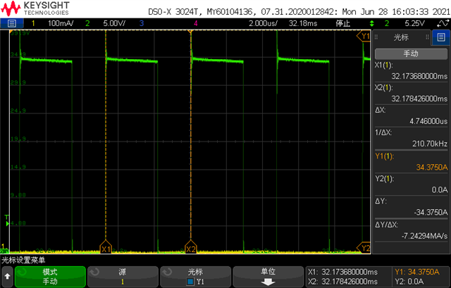

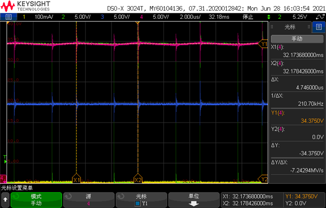

  • Hi Alejandro,
    Here is a schematic.
    Here is 2 scope.
    Green is SW PIN. On-time is 2.89us. Fre=210k.
    Red is Vin=34.3v
    Blue is Vout=19.4v
    Since we are make it works at constant current mode. So the on-time is halved than that not in CC mode.

  • Hi Mark,
    Let me reach out to the team internally for further inputs. I will get back to you as soon as possible.
