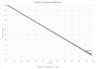

    Earlier today I sent a folder called "HV98 Learn Down Not Enough.zip", in that folder are 2 logs, number _2 and _3, I ran those in order so that you can see how the Learned FCC progressed.  Within the _3 (the last one run), I have a tab showing the graph showing:
    • RSOC - this is from the Bq78350-R1
    • MM RSOC - this is calculated as the discharge capacity as a percentage of the total discharge capacity removed from the pack
    • MM RSOC/FCC - this is calculated as the discharge capacity as a percentage of the Learned FCC at the start of the cycle.

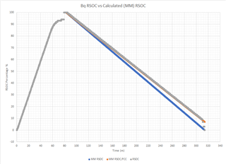

    Basically, If I had the RSOC that looks like it does, I'd expect it to adjust down or up so that the next cycle my expected has the same slope as the actual.  That being said, here is the graph that was in spreadsheet:
    When this cycle was done, as I mentioned previously, the Learned FCC had learned to 4148 even though I calculated 3908.56mAh.  I then manually changed the Learned FCC using BQ Studio to 3910 (nice round number near 3908.56).  I then charged the pack up, and discharged it under log.
    As you can see, I am calculating much closer to what the Bq is reporting.  We have the RSOC "hanging" there at 8% which tells me I should probably adjust my EDV voltages a little, right?
    The reason I care about this accuracy, if you look at the data for both tests, subtract 30 minutes from the last reading (EOD).  When there is truely 30 minutes remaining, on the test with a FCC of 4204, the reported remaining runtime was 47 minutes.  In contrast, on the test where I manually set the FCC to 3910, when I actually had 30 minutes remaining the Bq part reported that I had 27 minutes remaining, which is much closer.
    To add, at the end of this cycle, I actually took 3959 out of the pack where the FCC was 3910, the learned FCC updated to 4206.  Why did that go up so high?  That would put the next cycle exactly back where it was, which was innaccurate.
    Here is the data for that last test.
    HV98_Forced Learned FCC.zip
    Mike

  • Hi Mike,
    So I went through the log files today,
    For HV240_EDV_1a, I agree it is a little strange that the FCC learned up. I don't know if I have the .gg.csv file for this pack though.
    For HV98_11258_EDV_Log3, the log shows that the RSOC reached 7% before the EDV2 voltage was reached - so the gauge holds the Remaining Capacity and the RSOC at 7% until the EDV2 voltage is reached. Internally it is counting the additional discharge that occurred so it uses this to calculate the FCC higher so that on the next discharge the RSOC should reach 7% around the same time EDV2 is reached.
    For HV98_11311_EDV_2.log and EDV_3.log, it looks to me like the FCC is being updated correctly at the end of the log. On these 2, if I take the starting FCC minus the Remaining Capacity when EDV2 is reached, then divide by 0.93 (because it has discharged 93% down to 7%) I get the new FCC values.
    Regarding the device reaching 7% at the time that EDV2 occurs, this is where using compensation will help. The cell voltages are affected by temperature and current load, so compensation will calculate a more accurate EDV2 voltage if you were to run under different conditions.
    Matt

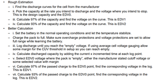

    My plan is to change to new values, and cycle multiple batteries tracking the RSOC vs my calculated RSOC to see how well they track together, and see how well Learned FCC updates.  As long as I keep the EDV2 at 7%, I don't need to change the Dod value right?  Or should I be reducing my "Battery Low%"?  Is there a certain spot in the discharge curve that I should be setting EDV2 to?
    Thanks, Mike
  • Hi Mike,
    This seems reasonable. It matches the "Better Calculation" approach for Fixed EDVs in the Using the BQ78350-R1 document.
    You should not need to change the Dod at EDV2 value - it would be good to set it to the default value which corresponds to 7%. (15232)
    The knee of the discharge curve is ideal because you want the slope to become steeper when detecting EDV2. This is usually around the 7% point for most Li-Ion battery cells.
    Matt
