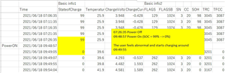

Could you please tell me the cause and how to deal with it?
attached log, gg file, golden image file
50001453_01.zip
regards,
Kagawa

    Please confirm you are using a NiMH type cell chemistry? This type of chemID has unique challenges mainly in the charge direction. Please make sure you are correctly getting a VCT event.
    1) The reason for the Jump to 100% is because FCC is going to 0mAh so 0RemCap/0Fcc is resulting in 100% RSOC. This will happen if Charge termination is learned low or resistance is learned too high whcih has the gauge simulate to FCC=0 right away.
    2) What do you mean by PowerOn? Do you mean you are starting the load?
    Eric Vos

    SOC and FCC were calculated by resetting the Ra Table and Cell V at Chg Term of DataFlash to the initial values.
    When only the Ra Table of DataFlash was returned to the initial value, SOC = 0%.
    The following are the initial values ​​of DataFlash and the values ​​of NG products.
    Battery is NiMH (4cell).
    Can you find out the cause of the SOC jump from these data?

    we experienced the same problem with the bq34z100-g1 and were pointed by a TI-employee that we had set the settings for 'Dsg Current Threshold', 'Chg Current Threshold' and 'Quit Current' incorrect. This caused the Ra-table to become dramatically unrealistic (you can check these), resulting in a wrong SoC calculation. The suggestion was to set 'Dsg Current Threshold' to C/16.7, 'Chg Current Threshold' to C/10 and 'Quit Current' to C/25. After this the SoC calculation at least did not show any jumps anymore and the Ra-table got corrected over time to more realistic values.

    You should confirm that the values stated above are correct (their respective C rating) otherwise the gauge will not know if it's charging, discharging, or if it can enter relaxed state.
