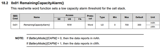

Q1) Is Word Read/Write for SBS Command and Block Read/Write for Mac Command?
Q2) How can I do if I want to write and read the parameter of SBS command (0x01 RemainingCapacityAlarm)?

    1. MAC Commands only use block read/write but the other SBS commands can be word or block. To determine which one to use, look at the Protocol.
    2. To read from RemainingCapacityAlarm(), perform a Read Word with command 0x01. To write, perform a write word with command 0x01 and the value you want to set.
