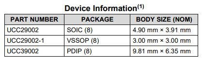

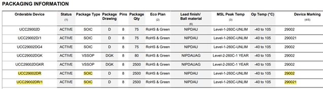

On the datasheet, UCC29002DR and UCC29002DR/1 are both the same as SOIC pakage, only the device marking is different, and there is no explanation for the other differences.

However, if you look at the packing information of the datasheet above, UCC29002DR and UCC29002DR/1 are both SOIC(8).

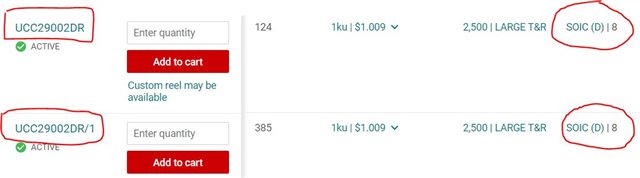

Can you tell me the exact difference between UCC29002DR and UCC29002DR/1?
It's the exact same device, but only the device marking is different?
If so, is there any reason to separate P/N?
Please confirm

    According to the information on the datasheet, UCC29002DR and UCC29002DR/1 are both SOIC-8, but UCC29002DR/1 and UCC29002-1 have different packages.
    UCC29002DR/1 is said to be UCC29002-1, but as indicated on the datasheet, UCC29002DR/1 is SOIC-8 and UCC29002-1 is VSSOP-8. Packages are different.
    Are you saying that the same parts are correct?
    So, is the package information on the datasheet wrong?

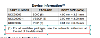

  • Hi Lee,
    I already highlight that they are not the same part.
    please ignore the first page of the datasheet.
    or you can take special on below captured.
