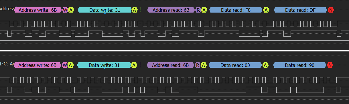

  • I see a similar problem, where IBAT and/or IBUS periodically report incorrect values during OTG operation. The actual battery and VBUS currents are steady (measured outside the part) as are all the other reported ADC channels, and I don't see any faults or changes in other registers. The incorrect currents are either very low values, or half the normal value and opposite polarity, like this...
    Normal: -1800 to -1900
    Incorrect: -10 to +10, or +900 to +050
    Below are register dumps in normal and false low current times, and also an i2c trace that looks fine in both cases.

  • Jim,
    Referring to Table 6. Battery Monitor Modes of Operation on the d/s, the ADC does not provide battery discharging current. It only provides the battery charging current in charge mode.
    Ning.
