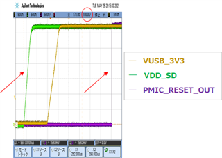

  • Hi Daniel
    Thank you for many advice,
    I attached scope shot of the startup, please see below;
    ・500μs/div, +3.3D_ON=REGEN1, VUSB_3V3=LDOUSB_OUT, VDD_SD=LDO1_OUT
    ・Zoomed the startup timing of LDOUSB_OUT (100μs/div)
    Compare with user's guide (below), actually LDOUSB_OUT and LDO1_OUT startup are occur 250μs delay.
    RESET_OUT startup timing look like 500μs later after LDOUSB_OUT startup.
    Please let me know if you have any notices.
    Satoshi
  • Hi Satoshi,
    From this scope shot it appears that LDOUSB is acting as described in the thread referenced by you in the original post. It comes up at the same time as LDO1 as described in the user's guide, except with the expected ~215us delay described by Karl in the other thread. Additionally, RESET_OUT has the proper delay after LDOUSB as described in the user's guide. It appears to be functioning within expectations.
