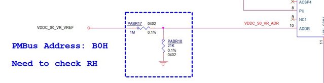

our customer use TPS53659 for Ampere platform.
Please help to confirm the upper resistor of ADDR pin if our PMBus address is B0H.
1M is oaky for me, could you help to double confirm? Thanks!

Hi Jimmy, yes, this will work for 0xB0. The pin voltage will be 1.7v*(21k/(1M+21k)) = 35mV
