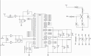

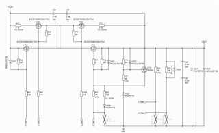

Hello! Must CHG FET and DSG FET turn on in autonomous mode? In our case Battery Voltage - 19.7 V, voltage on DSG FET gate - 8.5 V.
Hi Evgenii,
The FETs are disabled by default when the device is powered on. They can be enabled by sending the FET_ENABLE() command. Or you can write the FET_EN bit in the Mfg Status Init register. If this bit is programmed in OTP, the FETs will be enabled by default at power up.
Matt
