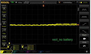

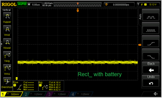

I have a note when testing:
When charging without battery connected, the output voltage is 1.6V
I connect battery to board, the output voltage raise to 4,2V
I continue disconect battery, the output still have 4.2V
Seem install battery when charging help BQ raise output right voltage when startup

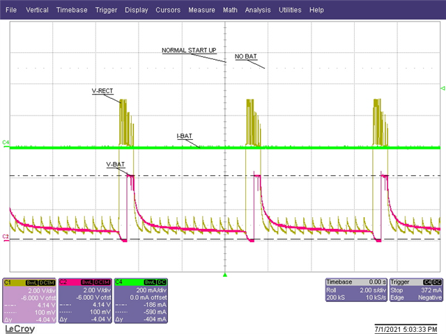

With no battery this is an image of the BAT voltage waveform. Note that this can vary based on what transmitter is used.
When you are seeing 1.6V was this an average voltage reading? Please attach plots of Vrect and Bat pin during startup.

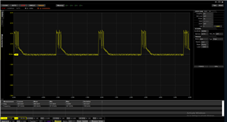

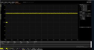

We will need to look at the waveforms of the RECT and BAT pin to take this further.
Nick
To see the full behavior of the transmitter the time base needs to be extended. In the image I attached we are using 2s/div.
Nick
Thank you for providing the updated waveforms. This looks like the normal operation of the device when no battery is connected.
