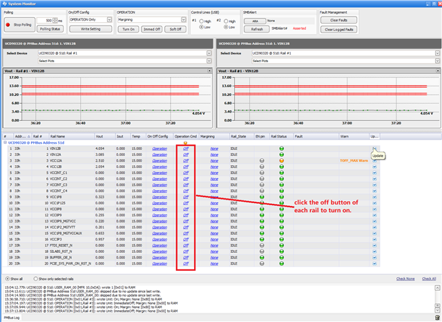

Our customer is using the UCD90320 power sequencer on their design.  He was in the process of writing a new config into the part on one of the boards when the power was interrupted.  After getting the power back, he plugged in the TI cable and used the Fusion software to load the new config into the part.  In this design he use one of the GPIO to turn the power on and off.  Now on that board when he turn the power off and then back on using the GPIO pin, he get a watchdog timeout error when he set the GPIO to on and the UCD goes through ~50 resets before the UCD will enable the POLs.  He have tried erasing the part and reprogramming it several time but he can't seem to get this behavior to stop.  Note that he don't have any watchdog timers enabled in his design. Also note that none of his other boards exhibit this behavior.

  • Hi
    I had reviewed the project file and schematics. The project file is working well on UCD90320 EVM. Of course, EVM does not have the power rails as in your board. But this tells that the configuration does not cause problem.
    There is no decouple cap(1nF) on the RESET pin. we recommend a 10k + 1nF on the RESET
    Do you see the same issue on other board with the same configuration so that we can know it is specific board related.
    In the original post, you mentioned that the device reset 50 times only when using GPIO to turn on the power. i assumed that the GPIO here is the pin N11. Could you please confirm?
    As you had confirmed that pin N11 or other DMON pis are not toggling randomly or with noise. I would like to try the following: instead of using pin N11 to turn on all power at the same time, please use the OPERATION COMMAND to turn on rails on by one. in this way, you can know which rail caused the problem.  please be ensure that N11 is LOW during the test.
    here is the snapshot of how to use system monitor to manually turn on rails one by one.
    Yihe

  • Turning the rails on one by one using the GUI all the rails powered up correctly.
  • Hi
    For me this particular boards have some cross talking, since turn on or off power shall not impact the UCD90320.
    The theory is that when some rails are ON, it may impact the VCC or RESET of the UCD90320 since you had confirmed there are no toggle on all INPUT signals.
    Yihe
