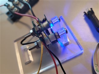

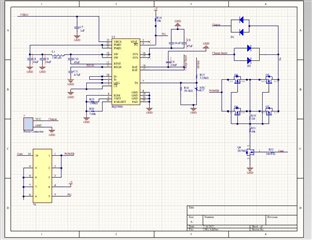

We have developed a 2 Cell BMS multilayer board design and have assembled 3 working prototypes shown in the picture below. I have also attached our schematics of the project. The middle schematic is where the BQ25886 comes in. We integrated it into our design with the same design that the datasheet shows and also have the PCB routes as wide as possible near the power path of the BQ25886 chip. When we plug it into a 5V source it only outputs 150mA. I am wondering why it will not go into CC CV mode. 5V @ 150mA is not enough power to charge the battery in a reasonable time.
How long do you have to wait for it to go from precharge/trickle charge/CC/CV? Can TI see any error in our design why this thing is not charging when it is plugged into 5V.

    Please refer to the schematic checklist document below. In particular, your schematic is missing capacitance on SYS and BAT. This is required even if you don't have a load connected to SYS.
    0005.BQ2588x Schematic Checklist.pdf
    Also, note that with the D+ and D- pins floating, the BQ25886 will detect an unknown adapter and set the input current limit to 500 mA. Please see Section 8.3.3.2 in the datasheet for more information about the input source type detection.
    Finally, the BQ25886 will not begin fast charging until VBAT rises above VBATLOWV (typical value of 6V). Before that, the BQ25886 will pre-charge the battery with only 1/10 of the fast charge current setting.

  • Thank you for the helpful information. We will incorporate that into our next design for this charger. Can you explain why it will not take an input current higher than 150mA at the moment?

  • Hi Angelo,
    I have attached an updated schematic with the changes made to the BQ25886. Do you think when plugged in this module will now provide the maximum current of 3A @ 5v?
    Thank You,
    Brendan
  • Hi Brendan,
    Yes, your circuit should allow 3A of input current. The D+ and D- pins are shorted together to indicate a DCP, and the ILIM pin is shorted to GND, which sets the input current limit to the maximum.
