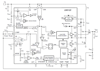

1. May you let me know the internal PWM signal amplitude? I mean the carrier waveform. (ignore the slope compensation)
2. If our duty < 50%, I would like to try to disable the slope compensation. Could I leave the pin floating directly?
3. Will the slope compensation affect the bode plot measurement?
